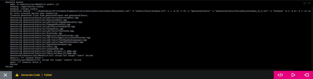

Hi, i keep getting this error. how can i solve it?
im using stm32h750-disco and touchgfx

i try with new version but at first stage already got this error

That is a very strange issue, are you sure that you are working in a project where you have the permissions to modify files ?
Did you try to create a new project using the stm32h750-disco board setup in TouchGFXDesigner, or did you generate code in a project created with a previous version ?
Can you also share your text.xml file please ?

Yes you can try to uninstall TouchGFX in another folder and try to create a new project also in a different folder.
Another question, why did you share the xml reader, validator and write ruby scripts in your .rar file ?

you ask me to share the text.xml file but i don't which one or where can i get the xml file.
Btw after i do some research. many say to include the path in G++ Compiler but where can i get or search for the library to put it into the path?
