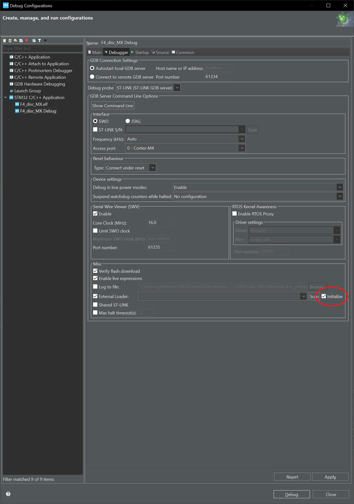

2022-07-11 2:38 AM
This could be because you need to initialize the external loader in your debug configuration inside STM32CubeIDE.
Do you know if this checkbox is checked?
2022-07-11 7:05 AM
It was unchecked, but checking it doesn't resolve the problem.
