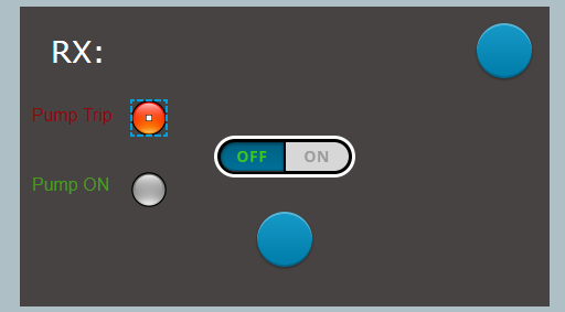

I am doing something similar but still learning how to do it. So far the closest example I found is the following https://www.youtube.com/watch?v=jQO7zhX0e0Q&t=2819s
On thouchgfx I have created an image with 2 possible led images gray and red.
On the viewer code I have added the followinng where animation1 is the name of the top led image.
void Screen1View::advanceAnimation()
uint8_t msg = 0;
if (xQueueReceive(gui_msg_q, &msg, 0) == pdTRUE)
animation1.setBitmap(Bitmap(BITMAP_BUTTON_BLANK_GRAY_ICON_ID));
animation1.invalidate();
else
animation1.setBitmap(Bitmap(BITMAP_BUTTON_BLANK_RED_ICON_ID));
When I press the button the virtual led turns from grey to red. But doesnt go back to gray once the button is released.
While I am trying to solve it any help is welcome
