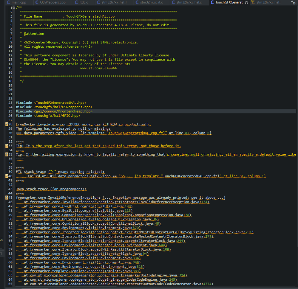

When I generate the code with STM32CubeMX version 6.3 for STM32H747XIHx something like this happens:
I have also noticed that when I chose TouchGFX component I am able to use it only with M4 core (this configuration was forced by CubeMX) what is also weird. This shouldn't matter which core uses LTDC/DSI and GFX library...
This is full "log"
FreeMarker template error (DEBUG mode; use RETHROW in production!):
The following has evaluated to null or missing:
==> data.parameters.tgfx_video [in template "TouchGFXGeneratedHAL_cpp.ftl" at line 81, column 6]
Tip: It's the step after the last dot that caused this error, not those before it.
Tip: If the failing expression is known to legally refer to something that's sometimes null or missing, either specify a default value like myOptionalVar!myDefault, or use [#if myOptionalVar??]when-present[#else]when-missing[/#if]. (These only cover the last step of the expression; to cover the whole expression, use parenthesis: (myOptionalVar.foo)!myDefault, (myOptionalVar.foo)??
FTL stack trace ("~" means nesting-related):
- Failed at: #if data.parameters.tgfx_video == "So... [in template "TouchGFXGeneratedHAL_cpp.ftl" at line 81, column 1]
Java stack trace (for programmers):
freemarker.core.InvalidReferenceException: [... Exception message was already printed; see it above ...]
at freemarker.core.InvalidReferenceException.getInstance(InvalidReferenceException.java:134)
at freemarker.core.EvalUtil.compare(EvalUtil.java:198)
at freemarker.core.EvalUtil.compare(EvalUtil.java:115)
at freemarker.core.ComparisonExpression.evalToBoolean(ComparisonExpression.java:78)
at freemarker.core.OrExpression.evalToBoolean(OrExpression.java:36)
at freemarker.core.ConditionalBlock.accept(ConditionalBlock.java:48)
at freemarker.core.Environment.visit(Environment.java:370)
at freemarker.core.IteratorBlock$IterationContext.executedNestedContentForCollOrSeqListing(IteratorBlock.java:291)
at freemarker.core.IteratorBlock$IterationContext.executeNestedContent(IteratorBlock.java:271)
at freemarker.core.IteratorBlock$IterationContext.accept(IteratorBlock.java:244)
at freemarker.core.Environment.visitIteratorBlock(Environment.java:644)
at freemarker.core.IteratorBlock.acceptWithResult(IteratorBlock.java:108)
at freemarker.core.IteratorBlock.accept(IteratorBlock.java:94)
at freemarker.core.Environment.visit(Environment.java:334)
at freemarker.core.Environment.visit(Environment.java:340)
at freemarker.core.Environment.process(Environment.java:313)
at freemarker.template.Template.process(Template.java:383)
at com.st.microxplorer.codegenerator.CodeEngine.freemarkerDo(CodeEngine.java:324)
at com.st.microxplorer.codegenerator.CodeEngine.genCode(CodeEngine.java:245)
at com.st.microxplorer.codegenerator.CodeGenerator.generateOutputCode(CodeGenerator.java:4774)
at com.st.microxplorer.codegenerator.CodeGenerator.generateSpecificCode(CodeGenerator.java:4133)
at com.st.microxplorer.codegenerator.CodeGenerator.generateSpecificCodeFile(CodeGenerator.java:1435)
at com.st.microxplorer.codegenerator.CodeGenerator.generateCodeFiles(CodeGenerator.java:1666)
at com.st.microxplorer.codegenerator.CodeGenerator.generateCode(CodeGenerator.java:1285)
at com.st.microxplorer.plugins.projectmanager.engine.ProjectBuilder.generateCode(ProjectBuilder.java:2347)
at com.st.microxplorer.plugins.projectmanager.engine.ProjectBuilder.createCode(ProjectBuilder.java:1939)
at com.st.microxplorer.plugins.projectmanager.engine.ProjectBuilder.createProject(ProjectBuilder.java:618)
at com.st.microxplorer.plugins.projectmanager.engine.GenerateProjectThread.run(GenerateProjectThread.java:54)Arek

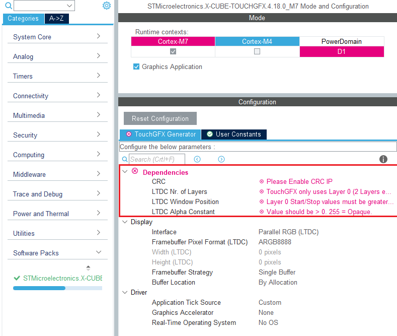

Did you generate the code without verifying the dependencies in TouchGFX configuration ?
I checked your .ioc file and I found that the TouchGFX generator and the clock are not configured.
Regards,
Sara.

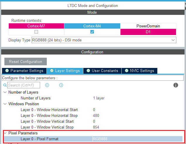

In the LTDC configuration you forgot to change the layer 0 pixel Format, if you set it to RGB888, the TouchGFXGeneratedHAL.cpp file will no longer have errors.

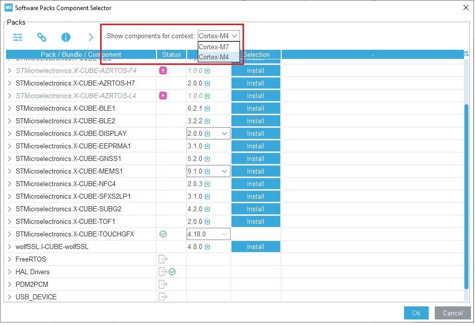

And if you want to use M7 core for TouchGFX component you just need to select Cortex-M7 in Show components for context in the Software Packs Component Selector ( Please refer to the figure below ).

2021-11-05 2:02 AM
Thank you very much, it works indeed.
I didn't expect I have a wrong setting for Pixel Format, because everything was working fine (except code generation). But good that you have noticed this mistake.
