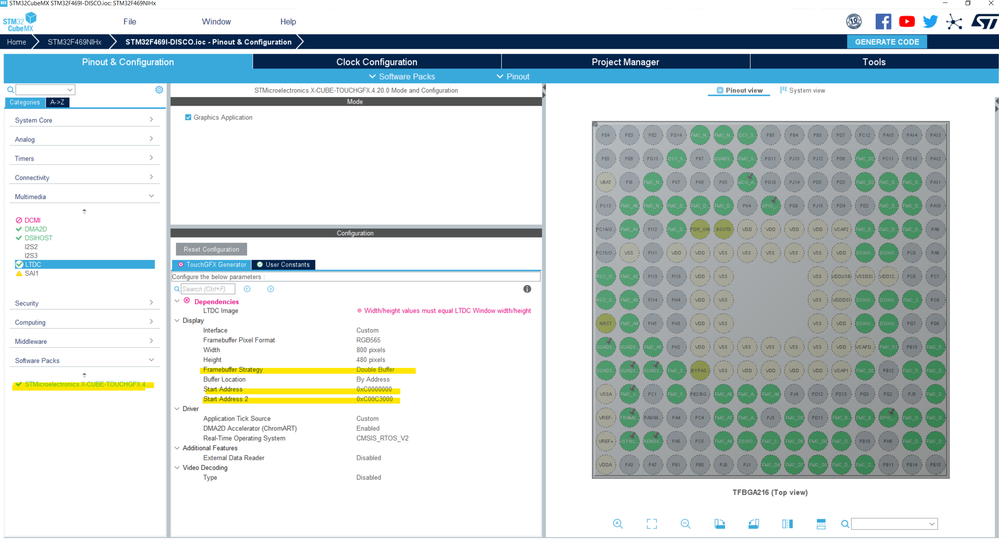

1- On STM32CubeMX, select "Double Buffer" as "Framebuffer Strategy". Set 0xC0000000 and 0xC00C3000 as the two start addresses.

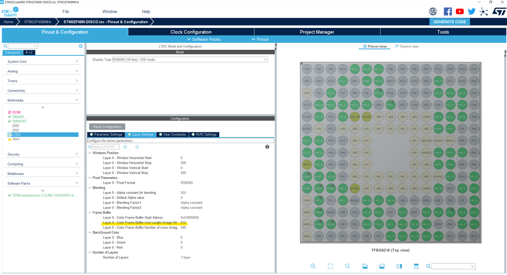

2- Configuration of the LTDC on STM32CubeMX : under "Layer Settings"> "Frame Buffer">"Layer0 - Color Frame Buffer Line Length", set "832" value.
The reason why we put 832 and not 800 as the Color Frame Buffer Line Length is because the DMA can transfer up to 208 pixel by VSYNC so 832 pixel after 4 VSYNC.
We can put 800 but the performance would be slower because we will need to make the calculation of sending 3*208 + 176
