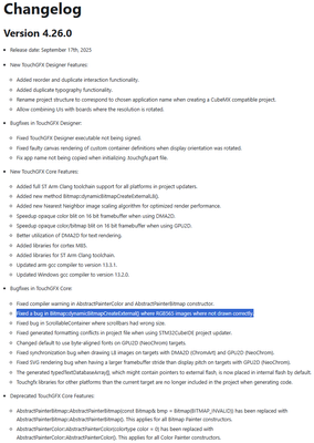

Hello, @GaetanGodart @JohanAstrup
I've run the same tests under TouchGFX 4.26.0, but I still run into the issue of the image looking grainy/faded. Does stm32cubeIde also need to be updated? I am running that on an older version (1.16.1)
static uint16_t cacheSize[512];
Bitmap::setCache(cacheSize, sizeof(cacheSize),1);
volatile BitmapId bmpId = Bitmap::dynamicBitmapCreateExternal(185, 43,(void*)image_logo, Bitmap::BitmapFormat::RGB565);

Hello @Priyank.
You do not have to update STM32CubeIDE.
Instead, try deleting the ST folder in the Middlewares folder and then regenerate code in TouchGFX Designer.
