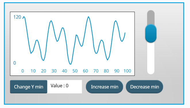

Hello again,
I modified this project to get closer to what you wanna do.
I think it cans provide you a nice first approach.
To explain quickly what I did :
For the code, I invite you to take a look at Screen1View.cpp, everything is in there.
This was done quickly and could be improved a lot, but I invite you to test it and to play with it. What you want to achieve is definitely doable.
Let me know if you have other questions.
/Yoann

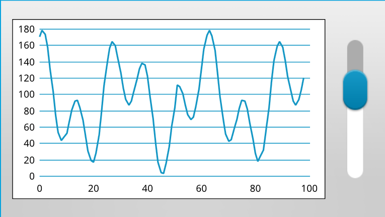

Thank you for the answer. unfortunately, I have 4.20.0. So I can't see that example. And the only example I can find is this one (for Simulator). Is it the same?

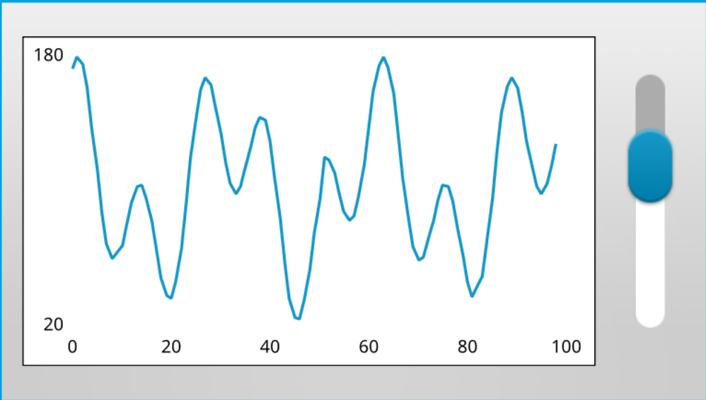

They adjust labels there but the problem is, I need to have only 2 labels: min and max. I need something like this:
But it feels impossible to do if my min is not 0.

Hello again,
/Yoann
