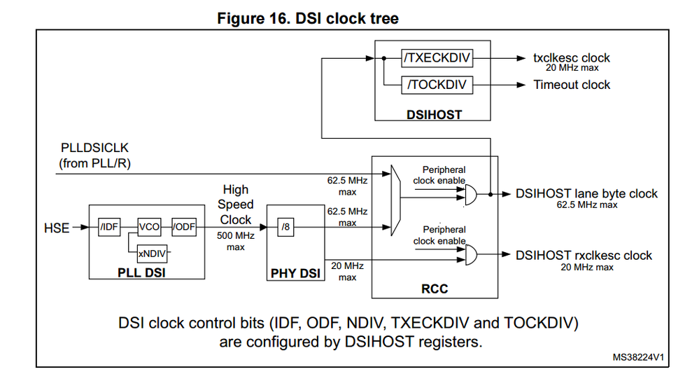

2017-03-24 5:24 AM
Dear Nesrine, Thanks a much for the confirmation. I didnt found AN4860 before. Can you tell where is the picture
above copied from ? I can't find it in my PDF.
In Reference Manual there for STM32F76XX is explicitly listed ''HSE or HSI''. See below.
Maybe it is documentation bug ?
M.
2017-03-24 5:58 AM
Hi
Devera.Martin
,The pictrue is copied from the DSI chapter on theSTM32F469/479 refrence manual :
-Nesrine-
