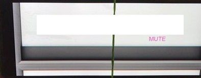

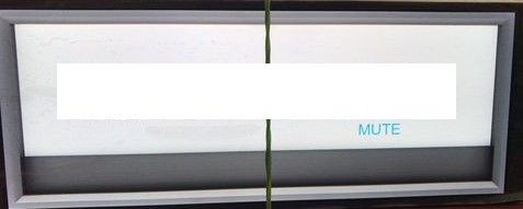

I have news and images,
maybe anybody have same issue.
Same code turened ON ok.
Same code next turn ON bad
I check memory and data is ok in mem position. Too i place one test point to left down corner after init display before start touchGFX rtos
and point is showed always properly and shifted after touch graphics make first show from black disp with only one point in corner.
Then i add to one button control code to start HAL_DSI_PatternGeneratorStart(&hdsi, 0, 0); Next press stop and miracle bad is corrected to ok.
Please help?
