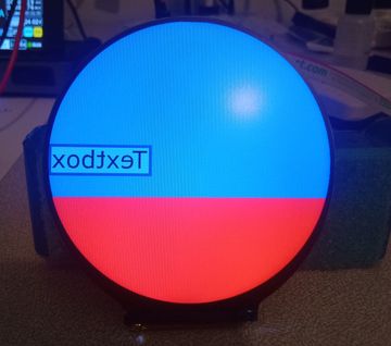

I am working with a custom board I designed using this display(LINK) They provide init codes on the product page that I have integrated into my project but they do not provide any any porch, timing or polarity information. I first setup LTDC and the DSI host and was able to display a solid color on the display by generating a frame buffer in code and setting each pixel. I then moved on to integrating touchGFX and was also able to get that working fairly easily but the display is mirrored on the x-axis as shown here:

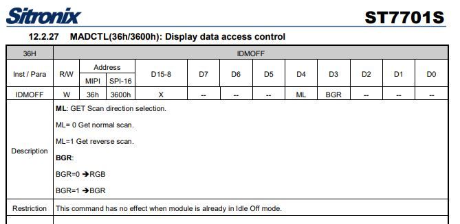

The display is using a ST7701s controller, I found the MADCTL register in the datasheet that I believe should be able to mirror the display but I am not getting the expected output.

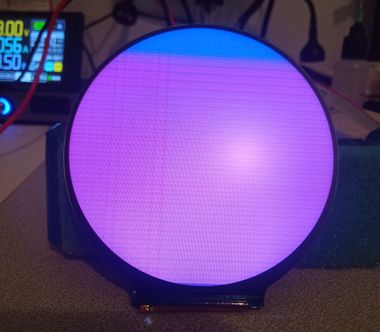

And this is the output after doing so
I have verified the ability to write to this register by setting the "BGR" bit to a 1 and the display will swap the red and blue channels, I am not sure where to even start with troubleshooting this issue.

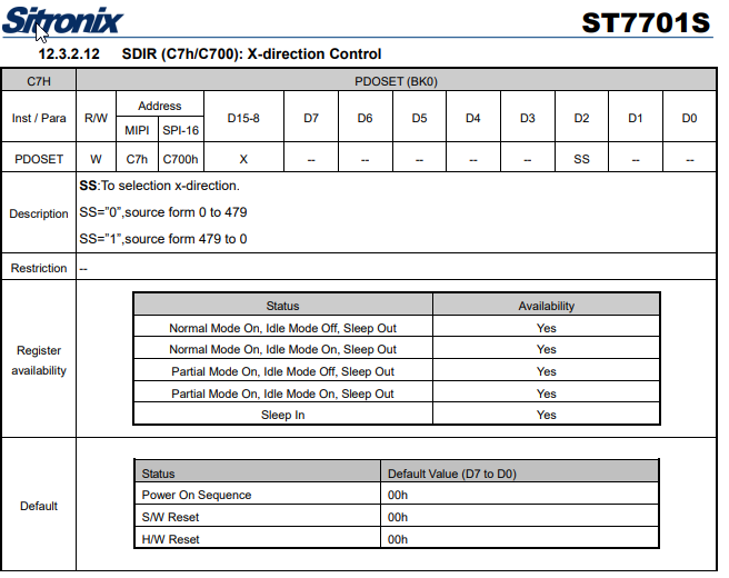

The init code sets the SS bit in SDIR. This will flip on the X direction. Remove that code, and you should be fine.

ML is used to flip vertically

I have also tried to change the SDIR (0xC7) register to SS=”1” source form 479 to 0, that makes no visible difference.
2024-11-09 7:03 PM
Thank you for your help, SDIR did turn out to be the correct register to control the screen being mirrored and I had previously tried setting it to both 0x00 and 0x04 with no change. I got an updated init code file from the display reseller that did work correctly, when I examined it for changes I also found register 0xCC to be changed to 0x18 vs the first set of init codes that had 0xCC set to 0x10. I have not found any documentation on what that register is for. I am going to mark this as solved and hopefully if anyone runs into this issue they can try changing the 0xCC register.

For SDIR to work you first need to enable Command2 BK0. It should look like that:
const char CND2BKxSEL = 0xFF;
const char SDIR = 0xC7;
char sdir = 0x04; // Mirror X on
const char CN2BK0SEL[] = {0x77, 0x01, 0x00, 0x00, 0x10};
const char CN2BKxDIS[] = {0x77, 0x01, 0x00, 0x00, 0x00};
// Enable BK0
command(CND2BKxSEL, sizeof(CN2BK0SEL), CN2BK0SEL);
// Apply SDIR
command(SDIR, 1, &sdir);
// Disable all command banks
command(CND2BKxSEL, sizeof(CN2BKxDIS), CN2BKxDIS);
