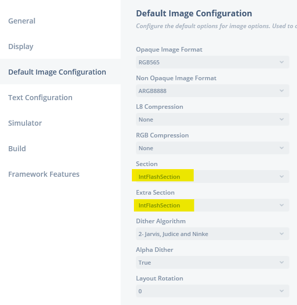

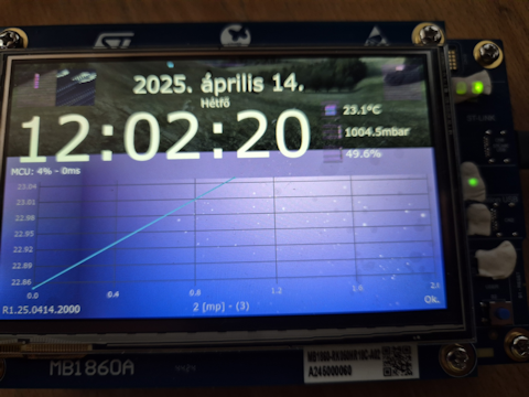

I have a funny issue. I just wanted to add a Share button to my Main Screen in an STM32TouchGFX of a working Weather Station app but when I built and run the app in STMCubeIDE all the widgets which uses background images showed surprising garbage images.
Then I changed the Section and Extra Section to IntFlashSection in Default Image Configuration group of Config menu of STM TouchGFX:
Then I rebuilt and run the app and everything worked just fine:

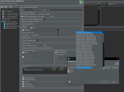

However, I saw that in STM32CubeIDE, you do not set the external loader on the debug.
To fix that, right click on your project in STM32CubeIDE, go to "Debug As" => "Debug Configurations" :
Then select your project followed by "debug", go to "Debugger", in the "External loader" section, click on "Add" and select your board:
Now you can try to flash on STM32CubeIDE.

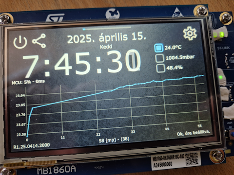

I have never tried to flash it from TouchGFX Designer, but I checked it and the Program All was selected in the Program and Run Target dropdown list. So I set the Section to ExtFlashSection (both) and flashed it from TouchGFX Designer. During building the app I found warnings in the log

Anyway, the result is a surprise. The right images appeared in all widgets even the external flash was selected in Config.
That probably means that I have a bad, faulty settings in the STM32CubeIDE.
