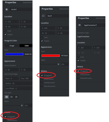

}Here are the settings for widgets and container:
Please note that 'draggable' must selected, otherwise setDragLimits-function call will give error. LogoContainer is simple container which holds just one image.
