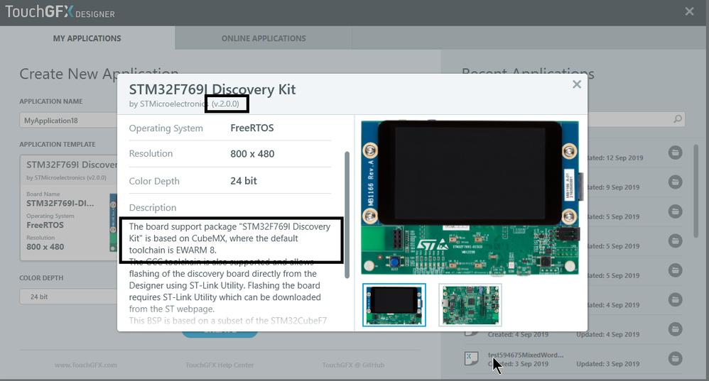

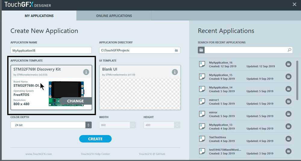

@Martin KJELDSEN
Thank You for the fast answer. I will try to compare the templates. Independently I am waiting for the functional CubeMX outcomes :). I will be obliged to you for giving me the hint how to find these templates. I haven't found too much in the CubeMX repositories.
Adam
2019-09-12 11:34 PM
Just start the TouchGFX designer :) All the templates are available there when you create a new application,
