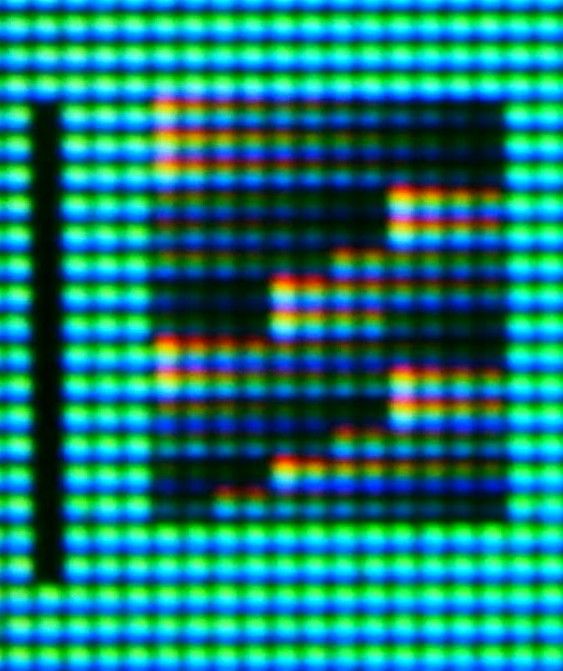

Here is a close-up of the distorted characters (on cyan background to visualize where pixels were written:
This image shows the gradient character. The black line next to it shows how tall the character is supposed to be. This is the only character from the transfer that was started outside of the DMA2D interrupt.

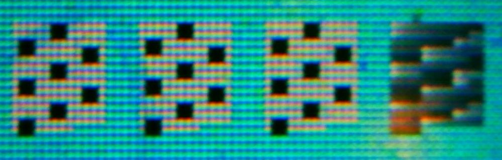

This image shows three of the of the vertical line characters and one more gradient character. The reddish hue on the last character is just some dirt, sorry about that.
The vertical line gets chopped up into 2x2 squares distributed all over the visible character. The gradient also shifts about every two lines. Interestingly, the characters are not fully drawn. Depending on the character (and whether or not the character was drawn already), some of the bottom lines may be fully or partially missing. Additionally, the shifting looks different depending on whether the MCU is cold-booting or reset using the NRST pin.
A closer look at the gradient characters shows that 4 pixels seem to go missing at a time, though I only checked the first few lines since it is sometimes not clear which pixels are missing.
