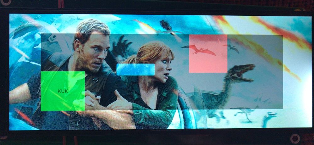

Where you read this fame ? L8 normaly work. And dual layer too but manualy managed. One example inner frame is L8 TGFX layer over layer ...
