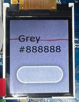

what information do you want? I will share you.
2024-11-05 6:40 AM
2024-11-06 2:19 AM
Hi Gaetan Godart,
Here are the result
Can you check in your driver the color format of the pixels?
0x05: 16-bit colour depth (5 bits for red, 6 bits for green, 5 bits for blue).

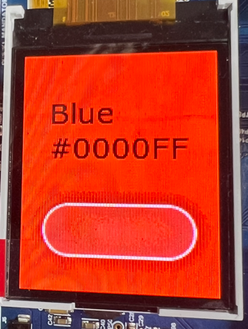

2024-11-07 2:14 AM
Hello @Mathan Raja ,
Thank you for the extra information.
In TouchGFX, the red and blue are clearly swapped. I don't know about before integrating TouchGFX.
What happens if you remove the change you made to fix it before integrating TouchGFX?
If you only use TouchGFX to control your display, this could work.
There is also a squiggly red horizontal line through the display that is not straight and of various shades.
Is it a pen drawing? This looks like nothing I have seen before as it is not straight
If it is not a pen drawing on top of the screen, could you try to set all the pixels to a single color without using TouchGFX, so before TouchGFX starts for instance (let's use green for safety :face_with_tears_of_joy:).
You could also use a logic analyzer to check if all the pixels' color were indeed sent as green.
Finally, you could try on another screen to see if the issue persists.
Also, weird thing, but the squiggly line is blue when you set the screen to blue (red in TouchGFX).

2024-11-08 12:27 AM
Hi Gaetan Godart,
The issue remains the same.
yes, it is a pen drawing.

2024-11-10 5:45 AM - edited 2024-11-10 5:46 AM
The ST7735 has a register called MADCTL (Memory Access Data Control), address 0x36. Notice that one of the bitfields is the RGB/BGR Order. You could try toggling this bit, which will tell the driver to interpret the red and blue channels opposite to what they currently are now.
In your project file drv_st7735.c, check the DRV_ST7735_SetRotation function. Notice that some pre-processor "if" sections set the madctl variable to the ST7735_MADCTL_RGB define and some others set it to ST7735_MADCTL_BGR.
Try swapping the ST7735_MADCTL_RGB with ST7735_MADCTL_BGR and vice versa for all rotation cases.
