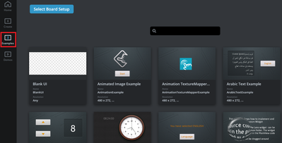

I had different versions of TouchGFX and when I downloaded 4.21.4 version it does not show demos. What can I do?

You need to go to "Examples" menu:

mƎALLEm

Hello @heyo ,
If your Example section is empty, it might be because your Designer is not able to connect to internet. Look at the top left if there is an exclamation mark.
If that is the case, you need to set up the proxy inside Designer and also set your location.
