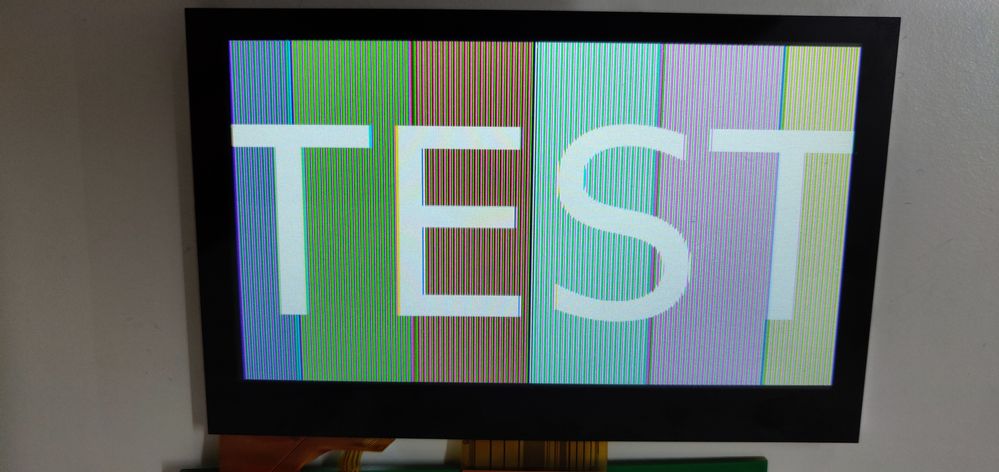

I changed that and this is my current image on my screen:
I have these stripes across my image.
Anyone with an idea what they are and how to change them?
The display driver have an option to swap the red and blue channel internally and I think that is one of the things happening. That is fixable - just swap the wires.
I have verified that I have a signal on all R,G and B pins and to be fair - im' pretty happy just to have a signal through. Now I need to optimize it.
2019-10-03 12:11 PM
Yes, does look that way
Also that the bit/byte packing across words might not be correct. Like the column order is reversed in groups.

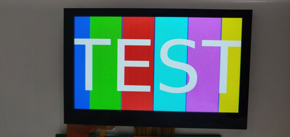

2019-10-03 12:23 PM
Oh my..
you're the MAN!
I changed to big-endian and boom! this beautiful image showed right up!
damn that was fast problem solving! 7 minutes!
I still need to swap the red and blue though but I'm going through a couple of PCB runs before I'm done with other peripherals..
