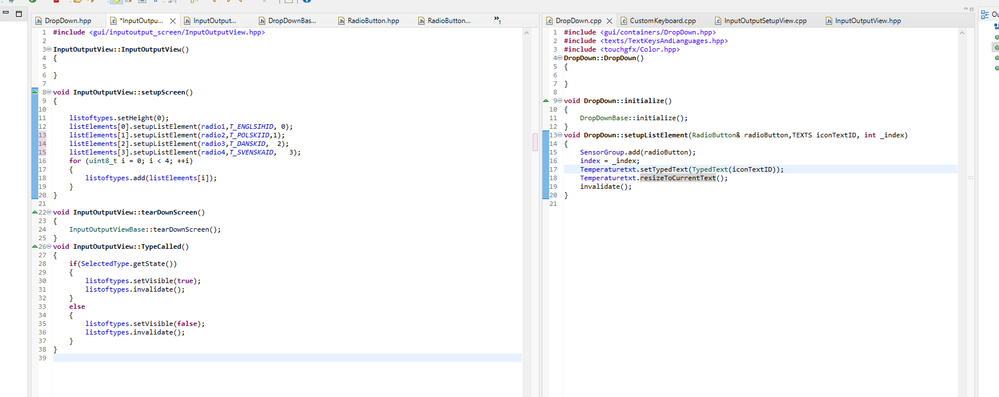

Ok. First of all I create one radio button in custom container:
Then I write this code in my custom container:
#include <gui/containers/example.hpp>
example::example()
void example::setupListElement(TEXTS iconTextID, int _index)
index = _index;
languagetxt.setTypedText(TypedText(iconTextID));
languagetxt.resizeToCurrentText();
invalidate();
int example::getIndex()
return index;
Then I put that container in my screen window: Screen1
My Screen1 code looks like that:
#include <gui/screen1_screen/Screen1View.hpp>
#include <texts/TextKeysAndLanguages.hpp>
Screen1View::Screen1View()
void Screen1View::setupScreen()
list.setHeight(0);
listElements[0].setupListElement(T_ENGLSIHID, 0);
listElements[1].setupListElement(T_POLSKIID,1);
listElements[2].setupListElement(T_DANSKID, 2);
listElements[3].setupListElement(T_SVENSKAID, 3);
for (uint8_t i = 0; i < numberOfListElements; ++i)
list.add(listElements[i]);
void Screen1View::tearDownScreen()
Screen1ViewBase::tearDownScreen();
void Screen1View::examplebuttoncalled()
if(examples.getState())
scrollableContainer1.setVisible(true);
scrollableContainer1.invalidate();
else
scrollableContainer1.setVisible(false);
}Start simulator and click on toggle button we see dropdown

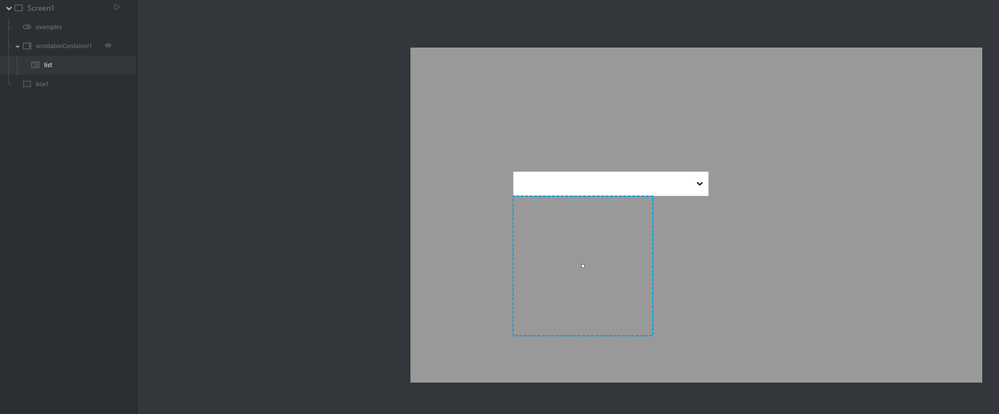

If I click for example english and polski it selects both of them(as usually if all buttons are in one group then if I click one option deselects another and so on).
So the question is this how to add all radio buttons in one group programmatically? In this project I use a lot of dropdowns and I need to create them dinammically because it allocate a lot of microprocessor memory.
