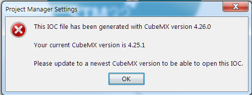

Posted on May 31, 2018 at 12:25
GHARBI.Nawres
On the
site
st.com
there is only the latest version 4.1
I really want to get a new version as soon as possible.
Many great thanks for the answer.
