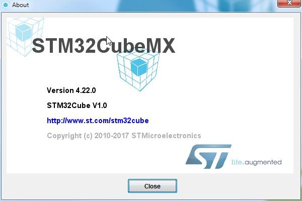

generated project into my IDE. I am using version 4.22 of CubeMX and#
My Project is for STM32F7-DISCOVERY boardThe IDE doesn't like these 2 lines of code:

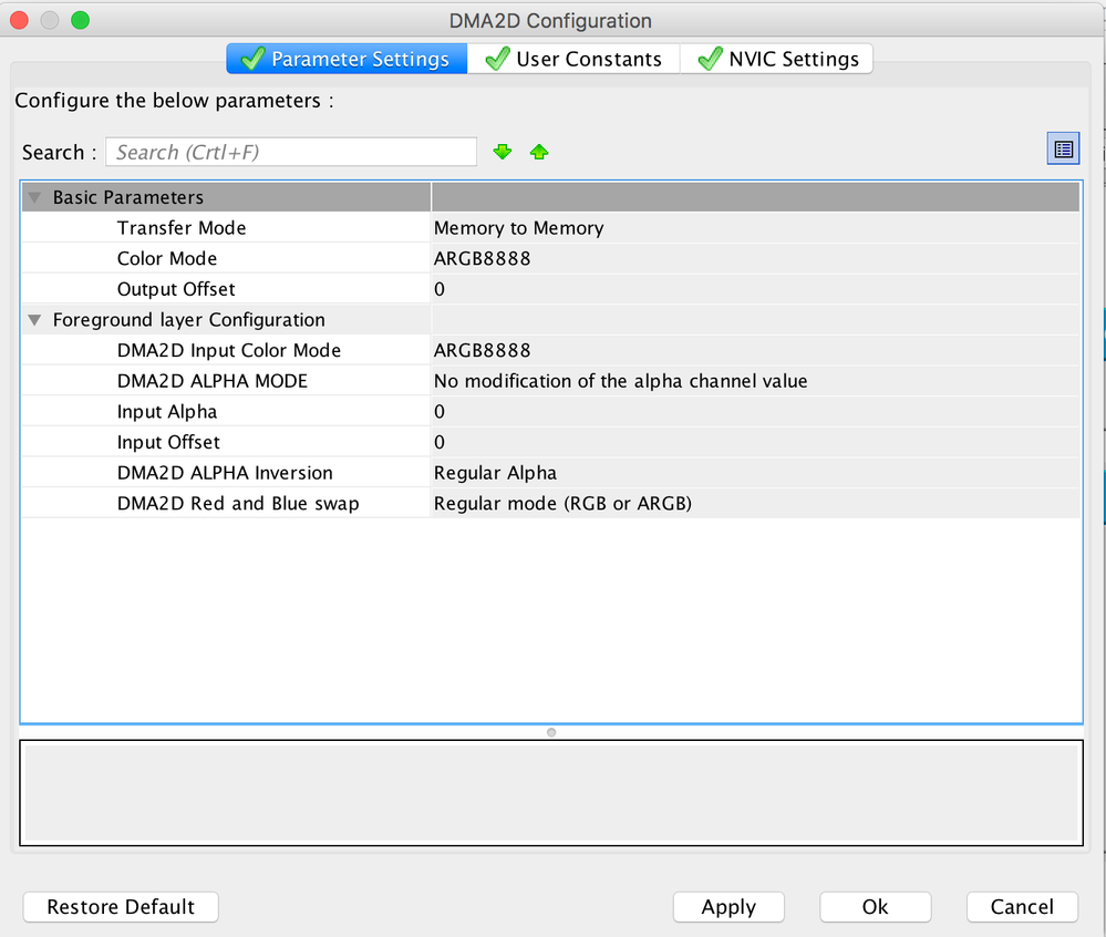

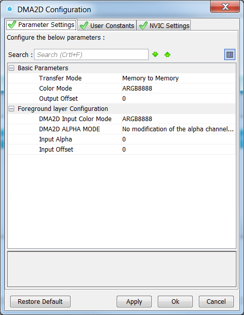

Hello Alex,
Can you please provide the ioc file for your F746 project?
CubeMX 4.22 does not provide the possibility to configure the Alpha inversion and Red&Blue swap parameters since they are not available for this MCU:
While indeed it is available for other series (ex: F767x):

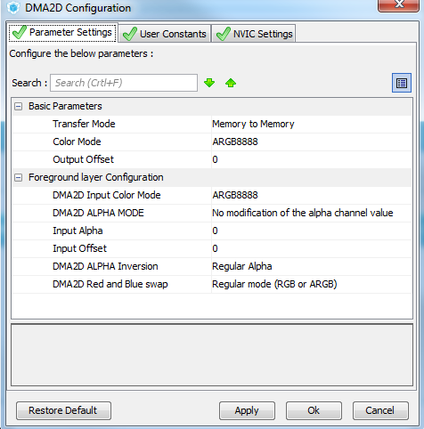

2017-08-08 10:14 AM
CubeMX (ver. 4.22) DMA2D config for STM32F746IG
________________ Attachments : 746IG_FMC_LTDC_DMA2d.ioc.zip : https://st--c.eu10.content.force.com/sfc/dist/version/download/?oid=00Db0000000YtG6&ids=0680X000006HyWb&d=%2Fa%2F0X0000000b94%2FNemg0iFxHhvs92YCUSnyh29YP1qplbku2XATdZJSKDI&asPdf=false2017-08-08 10:25 AM

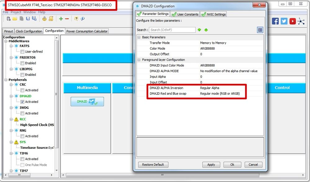

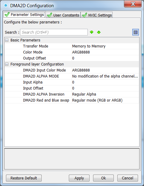

2017-08-08 1:08 PM
Dear Cube-T.
Your screenshots show that the CubeMX should not have the options that Vitaliy and I have,Alpha inversion and Red and Blue swap when working on F746 chip. I downloaded mine from the ST.com Web site.
