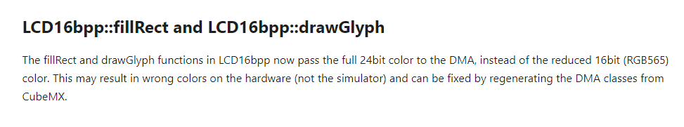

It seems this is a "known issue". For anybody else seeing this "issue"
https://support.touchgfx.com/4.18/docs/miscellaneous/known-issues

a) We were able to fix our issue by updating to the latest STM32F7DMA.cpp file
