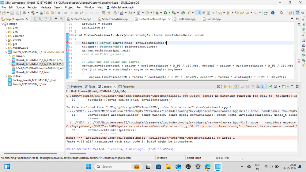

Hi, I’m encountering several issues when trying to build this code. It seems that some functions might be missing from the canvas libraries. Could you provide the supported libraries or functions? Please see the attached file for the specific issues I’m facing.

Hello @sai1 ,
It looks like you are using old libraries. To get the newest, try to regenerate code from STM32CubeMX.

2025-02-28 2:38 AM
Hi sai1,
did you succeed with building your own widget? I"m getting exactly the same errors as you've shown on the above picture.
I"m using TouchGFX version 4.24.
