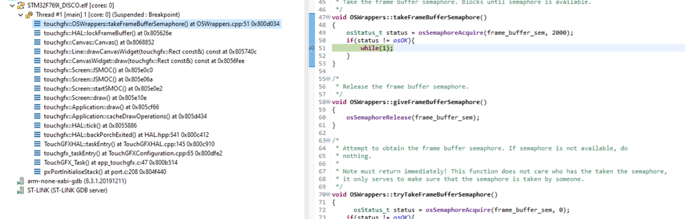

Update 3: I thought that loading the texts from the QSPI may have had something to do with it, but moving the Text and Font flash sections to the internal flash yielded the same results. That said, I did get a hang in a Line Draw() method, so that rules out the Texts or Wildcards as being issues specifically. Here is a recent crash. I set the timeout from osWaitForever to 2000, so that I could catch the exact stack trace that was waiting on the framebuffer.

Okay, the framebuffer semaphore is not available. Are you running a single framebuffer configuration? Which display interface are you using? You may not be triggering TouchGFX to release the semaphore.
/Martin
2021-04-07 6:04 AM
Single framebuffer, "Custom" interface (in cubemx) with ChromArt. Built on top of the STM32F769-DISCO 3.0.0 template, though I have added other peripherals. I don't know if this information helps, but I replaced while(1) with giveFrameBufferSemaphore(); takeFrameBufferSemaphore(); in the status check but it remained frozen. I could see from instruction stepping it was looping somewhere in the drawGlyph function.
