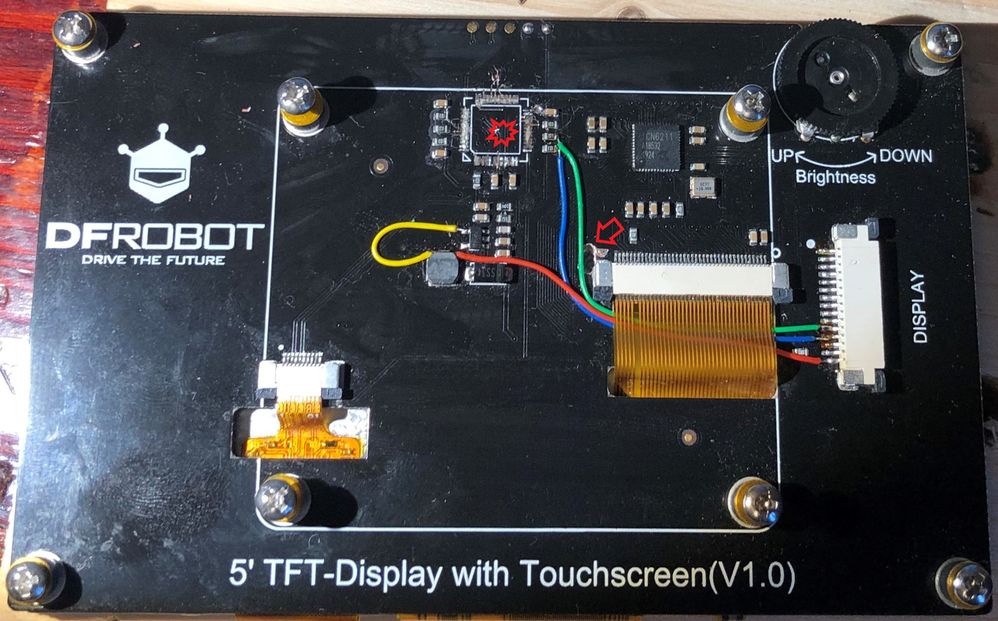

2021-07-20 11:50 PM
@Karan Kolhe MIPI parallel interface (LTDC) is well documented. OTM8009a is not a problem, that is also well documented.
However, that is not a typical RPI display - and that is problematic due to lack of documentation and protection techniques used.
How I got it partially working? I took DF Robot DFR0550 display, desoldered STM32F103 chip, connected I2C lines directly (green and blue wires) and voila!
I also had to hard-enable step-up voltage converter (yellow wire), red wire was not needed - it connects the VDD track I broke for test drilling a hole next to display connector.
This Linux driver looks promising. Any success yet?
