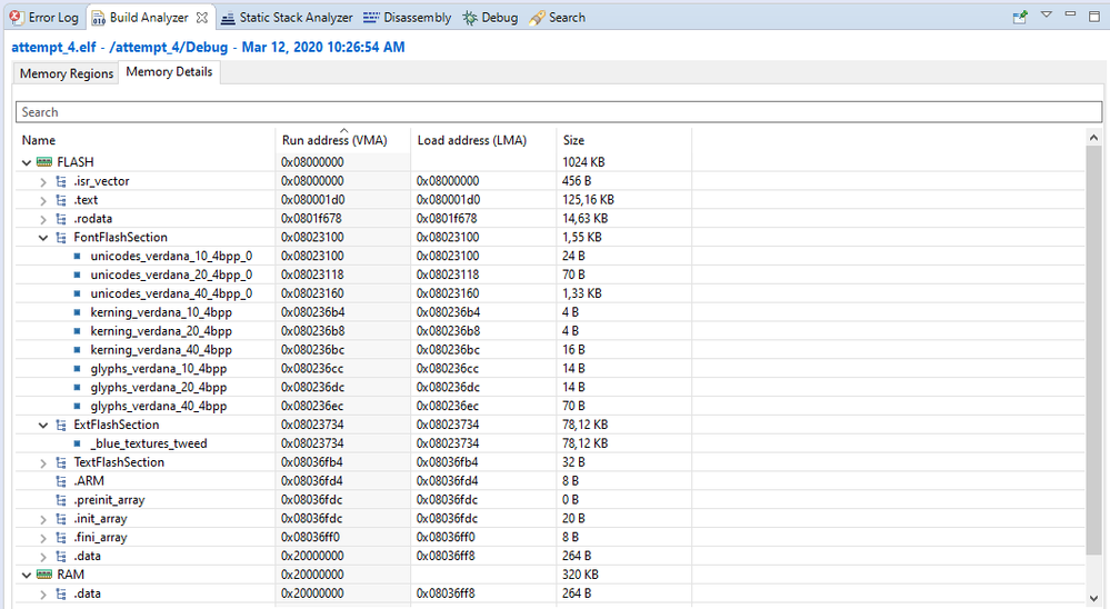

Yes, STM32F746G-DISCOVERY. QSPI is only needed for storing large images if the controller's FLASH memory is not enough?
I figured it out.
Deleted #include <stm32746g_discovery_qspi.h> from STM32CCubeIDE -> Project -> Core -> main.c
Deleted "stm32746g_discovery_qspi.c" and "stm32746g_discovery_qspi.h" from STM32CCubeIDE->Project->Drivers->BSP
Deleted "n25q128a" from STM32CCubeIDE->Project->Drivers->BSP->Components
‎2020-03-12 1:37 AM
Great. I have just figured out that I actually didn't used QSPI :)
