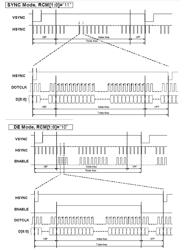

However, I am still not sure how are the LTDC parameters HSW HSP HFP VSH VBP VFP values calculated. From the datasheet https://datasheetspdf.com/pdf-file/947545/SaefTechnology/SF-TC240T-9370A-T/1 There are no information that talk about the the parameters I need to set up LTDC properly. Could anyone guide me how to extract those numbers from the datasheet?
These parameters are configured based on the LTDC timing registers. You find an explanation in AN4861 (LCD-TFT display controller (LTDC) on STM32 MCUs).
