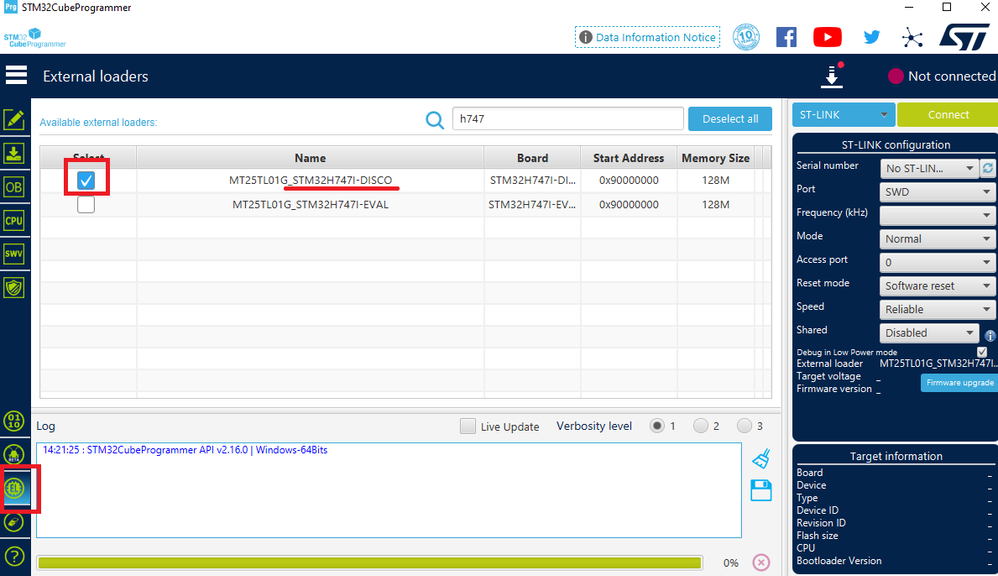

Ok. Then proceed as the following (after compiling the two projects relatad to the two cores):
With STM32CubeProgrammer, upload the two hex files related to CM4 and CM7 projects:
1- <Your_project_location>\STM32CubeIDE\CM4\Debug\STM32H747I-DISCO_CM4.hex
2- <Your_project_location>\STM32CubeIDE\CM7\Debug\STM32H747I-DISCO_CM7.hex
3- Reset the MCU.
If that works, that's because you would run the application in debug mode which is a bit tricky.
PS: before uploading the hex file related to the CM7, make sure you selected the external flash loader for this board:

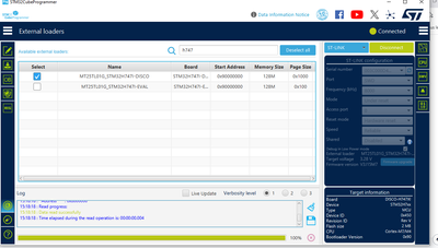

2025-04-06 7:24 AM - edited 2025-04-06 7:38 AM
I didn't understand your answer correctly but I opened stmprogrammer and I found this file and I clicked on connect, what is this file for? Is it for you to upload this file and then I upload the project if it explains to you what exactly needs to be done?
2025-04-06 7:45 AM - edited 2025-04-06 7:46 AM
This the flashloader used by STM32CubeProgrammer to upload the external Flash (QuadSPI). The quad SPI flash contains the TouchGFX assets: images, texts etc..
Select that Flash loader then upload the two hex files as I mentionned before. Did you see somthing on the screen?
