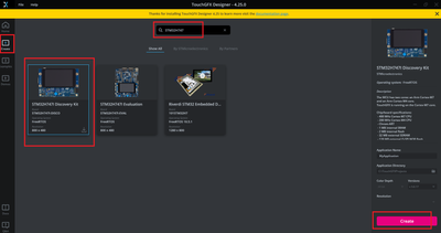

Hello @slimani and welcome to the ST community,
Please use TouchGFX designer tool to create a ready-to-use graphic project based on that board. The hardware will be configured automatically: LCD, Frame buffer, TouchScreen, memories, etc ..
As shown in this screenshot, find your board and click on create button:
Hope that answers your question.

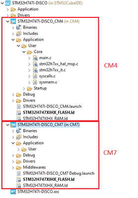

You are using a dual core product and there are two projects related to both cores CM4 and CM7. Make sure to upload the two binaries of both cores:
No relation with activating a timer with the display.

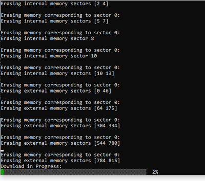

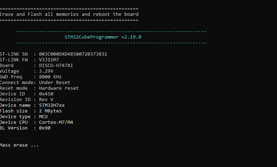

Download this STM32H747I-DISCO compiled demo binary (use STM32CubeProgrammer). If the blackscreen still there, I assume your board is broken.
2025-04-05 10:19 AM
I download it how do I upload it to stm32
2025-04-05 10:25 AM

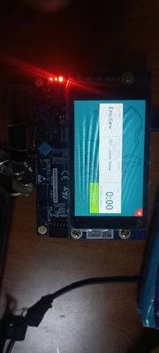

2025-04-05 10:34 AM
finally it works
