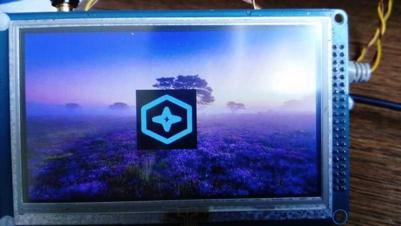

2020-03-27 6:48 AM
Hello, I still haven't been able to properly start DMA2D, below the photo and configuration, maybe someone will be able to show me where I am making a mistake.
DMA2D->CR = DMA2D_CR_MODE_1; // Mem to Mem with Blending
DMA2D->OPFCCR = DMA2D_OPFCCR_CM_1; // out format RGB565
DMA2D->FGPFCCR = 0xff000000|DMA2D_FGPFCCR_CM_1; // foreg. in format RGB565
// DMA2D->FGCOLR = 0x00050605; // color register foregrund 565
DMA2D->FGOR = 0x00000000; // ofset foregrund
DMA2D->OOR = 0x0000017c; // output ofset 380
DMA2D->NLR = 0x00640064; // size of ikons 100*100
DMA2D->OMAR = (uint32_t )(LCD_FRAME_BUFFER+45300); // out buf plus ofset
DMA2D->FGMAR = (uint32_t )(ikon); // in ikon foregrund
DMA2D->BGMAR = (uint32_t )LCD_FRAME_BUFFER; // in picture backgrund
// DMA2D->BGOR = 0x000000ff;
DMA2D->BGPFCCR = 0xff000000|DMA2D_BGPFCCR_CM_1; // backg. in format RGB565
// DMA2D->BGCOLR = 0x00050605; // color register backgrund 565
// DMA2D->OOR = 0x000000ff;
DMA2D->CR |= DMA2D_CR_START;
tft_cls(BLACK);
tft_bitmap(0,0,(uint16_t*)LCD_FRAME_BUFFER,480,272);We’re moving the ST Community to a new platform to give you a better and more reliable community experience.
