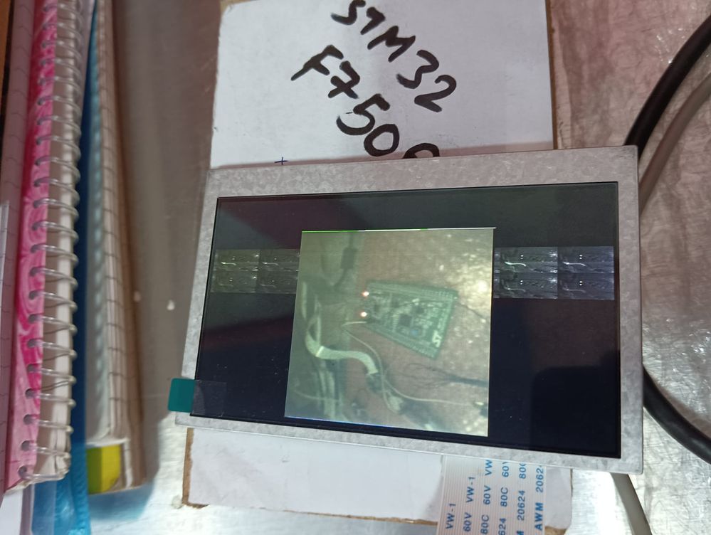

2022-12-03 1:24 AM
Hi kaouthar,
I have already configured VSYNC,HSYNC and LTDC clock as per the datasheet.
but still I'm not getting camera image output as excepted. you can see below lcd output image which I'm getting and please find below attached video file for your reference. thank you.
2022-12-05 9:00 PM
Hi kaouthar,
i have configured the display now its working by changing the lcd and camera buffer size.
