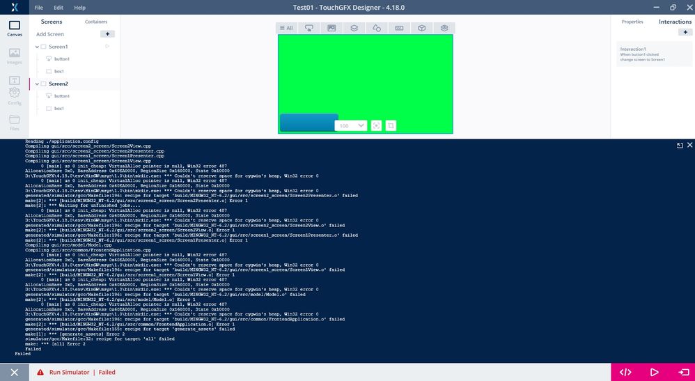

I need a help or guide.
I have a problem with TouchGFX.
I updated Windows to Windows 11 recently.
I can't compile it after it is updated.
This is my error message.
Run Simulator
Generate
Done
Generate Assets
make -f simulator/gcc/Makefile assets -j8
Reading ./application.config
Done
Post Generate
touchgfx update_project --project-file=simulator/msvs/Application.vcxproj
Done
Compile
make -f simulator/gcc/Makefile -j8
Compiling gui/src/screen2_screen/Screen2View.cpp
Compiling gui/src/screen2_screen/Screen2Presenter.cpp
Compiling gui/src/screen1_screen/Screen1Presenter.cpp
0 [main] us 0 init_cheap: VirtualAlloc pointer is null, Win32 error 487
AllocationBase 0x0, BaseAddress 0x60EA0000, RegionSize 0x160000, State 0x10000
C:\TouchGFX\4.18.0\env\MinGW\msys\1.0\bin\mkdir.exe: *** Couldn't reserve space for cygwin's heap, Win32 error 0
make[2]: *** [build/MINGW32_NT-6.2/gui/src/screen2_screen/Screen2View.o] Error 1
generated/simulator/gcc/Makefile:196: recipe for target 'build/MINGW32_NT-6.2/gui/src/screen2_screen/Screen2View.o' failed
make[2]: *** Waiting for unfinished jobs....
Compiling gui/src/screen1_screen/Screen1View.cpp
generated/simulator/gcc/Makefile:196: recipe for target 'build/MINGW32_NT-6.2/gui/src/screen2_screen/Screen2Presenter.o' failed
make[2]: *** [build/MINGW32_NT-6.2/gui/src/screen2_screen/Screen2Presenter.o] Error 1
make[2]: *** [build/MINGW32_NT-6.2/gui/src/screen1_screen/Screen1Presenter.o] Error 1
generated/simulator/gcc/Makefile:196: recipe for target 'build/MINGW32_NT-6.2/gui/src/screen1_screen/Screen1Presenter.o' failed
Compiling gui/src/model/Model.cpp
generated/simulator/gcc/Makefile:196: recipe for target 'build/MINGW32_NT-6.2/gui/src/screen1_screen/Screen1View.o' failed
make[2]: *** [build/MINGW32_NT-6.2/gui/src/screen1_screen/Screen1View.o] Error 1
make[2]: *** [build/MINGW32_NT-6.2/gui/src/model/Model.o] Error 1
generated/simulator/gcc/Makefile:196: recipe for target 'build/MINGW32_NT-6.2/gui/src/model/Model.o' failed
generated/simulator/gcc/Makefile:155: recipe for target 'generate_assets' failed
make[1]: *** [generate_assets] Error 2
simulator/gcc/Makefile:32: recipe for target 'all' failed
make: *** [all] Error 2
Failed
Failed

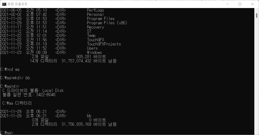

Hmm. Could it be a buggy Cygwin mkdir.exe?
Try to play with it separately - does it fail outside of CubeIDE?
Is your computer managed by your company's IT and they recently installed or updated some "security" a-s-s-cover-ware?
2021-11-29 5:22 PM
Yes, I tried to mkdir in the Command window.
It works fine.
