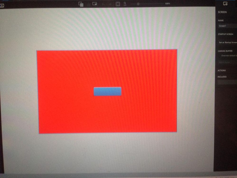

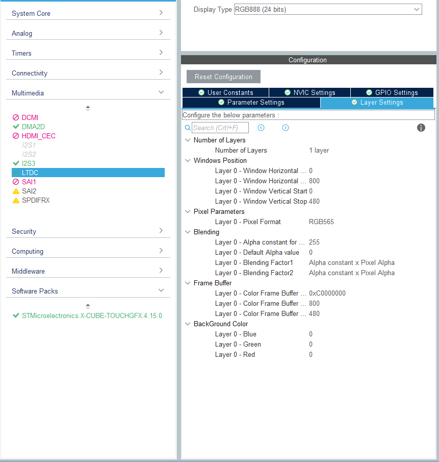

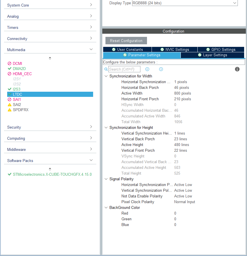

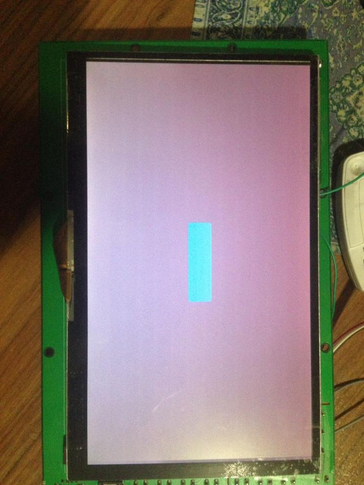

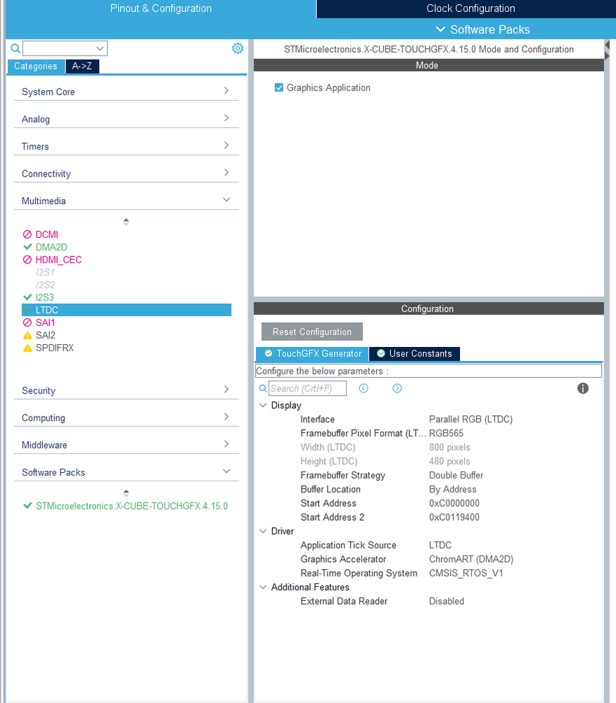

recently, I am working on a project with STM32F746 and 9" LCD with GT911 touch panel, everything is working fine except the colors in the LCD appears lighter than expected in TouchGFX design! maybe something wrong with the settings So I uploaded some pictures about LTDC and TouchGFX settings. Any help would be grateful.

@KnarfB @MM..1 The problem solved. It was due to the lack of one of the TFT bias voltages on the PCB (Vgh). it had to be 17 volts but there was a failure in the boost converter chip, So replaced and now the LCD works correctly.
Thanks for your efforts guys.
For those who have the same issue:
1-Double check the TFT voltage biases (Vcom-Vgh-Vgl-AVdd-...).
2-if the bias voltage chips have an EN pin, make sure to enable the IC's first.
3-if there is the external ram (FMC), make sure to configure it correctly and double-check the color frame buffer in cubeMX to be correct (mine is 0xC0000000).

I see you setup LTDC as RGB888 display, have you realy 24 color pins on MCU connected to LCD ?
When yes and you have amount in external ram i recommend use RGB888 for framebuffer too and same TouchGFX.
2020-12-16 9:02 AM
@MM..1 yes, I connected RGB888 pins of LCD to the STM32 MCU and it has 256Mbit RAM Chip, actually I experienced some strange issues like flikring when change the color depth to RGB888 So decided to leave it RGB565.

Some displays have too control interface and before use need send register values about setup, then RG888 in ltdc need set display to same mode.
When you have flik you need better values for pixel clock and porchs.
To check connection for colour bits. LCD need R7-R0 connect to same pins on MCU. And for setup LCD is good start point use color pattern of basic colours.
When your display is setup and connected without failure, then only porchs values vs pixel clock in stm is bad.

I checked every possible configuration about pixel clock and porches but still no luck :expressionless_face:
