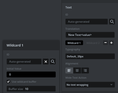

Hello @vasilevskialeksandar,
Did you think about checking the Use wildcard buffer check box and giving an initial value to the wildcard, like here:

2023-12-04 6:37 AM
Thanks. It works this way. I was not aware that Wildcard 1 is clik-able.
Also I needed to remove textArea1.setWildcard(myBuffer); //Note if some beginner read this thread.
Need to refresh my C++ knowledge to understand why my old way does not work since it is basically same thing.

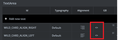

2023-12-05 1:35 AM - edited 2023-12-05 1:43 AM
I think your code does not work because you do not set TypedText for the textArea1.
TypedText must contain magic code '<>' in order for Gfx to display what you copy into Wildcard buffer.
What I do is, in the Text View Tab, I create TypedText for each alignment containing '<>' only:
Then, you use generated TEXTS::Ids ( TextKeysAndLanguages.hpp ) to initialise textArea1 :
void MainView::setupScreen ()
textArea1.setWildcard ( myBuffer );
textArea1.setTypedText ( TypedText { TEXTS::T_WILD_CARD_ALIGN_LEFT } );
After that, your code should work as intended:
void MainView::update_text_field ( uint16_t new_val )
Unicode::snprintf(myBuffer, 20, "%02d",new_val);
textArea1.invalidate();
