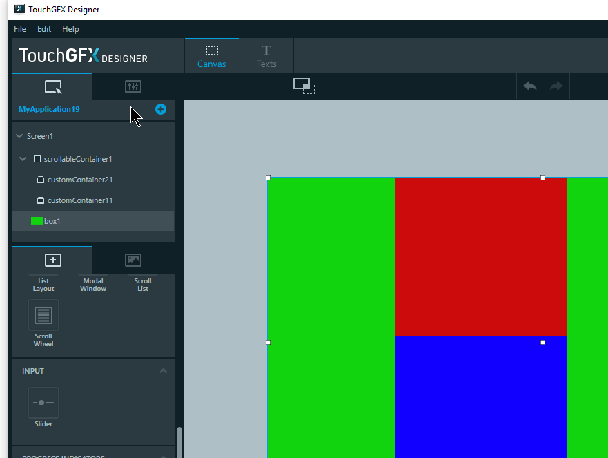

2019-09-16 4:32 AM
Hi @Dejan Nedeljkovic,
No problem. You can configure the z-order of widgets in the designer by simply dragging them up and down. In this application, the green box is the background (Furthest down in the widget tree).
2019-09-16 4:47 AM
Thank you, that helped.
