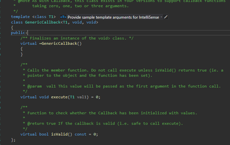

2025-01-05 4:40 AM
"what is "override final", what is the goal of isValid method"
Have a look into \touchgfx\Callback.hpp
https://stackoverflow.com/questions/29412412/does-final-imply-override
"I do not understand where to put the step 1 code."
Sorry about my previous confusing reply. Example attached using forEachChild(). But only Y position of all children of container is changing.
I see that setAlpha() is not member of Drawable. Hm.. Not sure what to do now. Seems you need to set alpha for each button individually.
"Do we absolutely have to create a new class to use this function ?"
I think so, yes.
