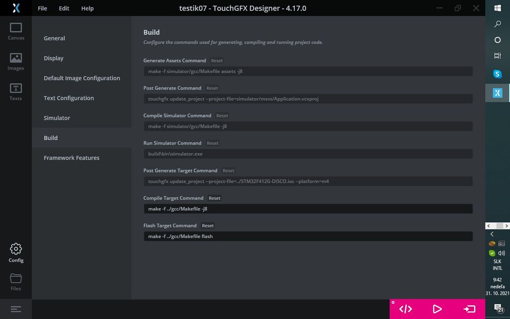

2021-10-31 1:49 AM
After install Designer on your desktop is two shotcuts. One Designer and second command promt envi setup for make.
And here is lines for make : usable directly from GUI...
when you use command line envi , make need run in right folder as you can see on image.

2021-10-31 6:17 AM
TouchGFX MinGW development environment version 4.17.0 for windows
Refer to local windows drives using the following notation: '/<drive-letter>/'.
To navigate to folder e.g. c:\projects type:
cd /c/projects
To compile and run a TouchGFX example, navigate to application folder.
Compile the simulator:
make -f simulator/gcc/Makefile -j6
Finally, run the simulator:
./build/bin/simulator.exe
marian@PC25 ~
$ cd /c/TouchGFXProjects/testik07/TouchGFX
marian@PC25 /c/TouchGFXProjects/testik07/TouchGFX
$ make -f ../gcc/Makefile -j8
Reading TouchGFX/application.config
Linking TouchGFX/build/bin/target.elf
Producing additional output formats...
target.hex - Combined internal+external hex
intflash.elf - Internal flash, elf debug
intflash.hex - Internal flash, hex
extflash.bin - External flash, binary
$maybe yout toolchain work too, simply cd as instruction say...
