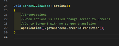

You first have to make sure that TouchGFX generates the function to go to your screen.
To do so, you could, in a random screen, just not the screen you want to go to, create an action, create an interactions where the action is the trigger and the action of the interaction is to change screen to the screen you want to go to.
This will make TouchGFX generate a function to go to that screen but it will never be called as long as you don't the action.
Now you can use the function to go to your screen.
You can find the generated function in gui_generated => src=> name of the screen where you created the interaction :
