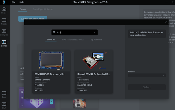

2025-05-29 1:47 AM
Also in board selection
