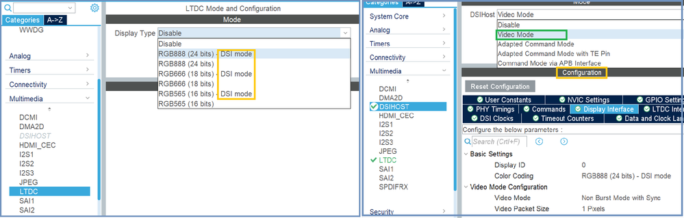

The answer is yes, for the F769 Disco board, the DSIHOST can be configured with video mode through CubeMX, you need to first Activate HSE clock under RCC to be able to access to DSI. To select the video mode, the LTDC must be configured with a DSI mode.
Now, it's up to you to configure your IPs according to your needs =)
