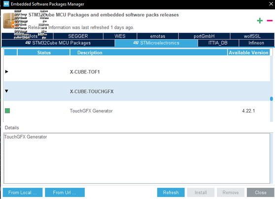

2024-02-04 9:30 AM
It only shows version 4.22.1 as the lastest.
What can I do to get that version?

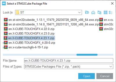

2024-02-04 10:07 AM - edited 2024-02-04 10:11 AM
Hi
I guess you have allready download th 'en.X-CUBE-TOUCHGFX.4.23.1.zip'. Just press From Local and browse the zip file.
Latest version is not yet available thru the CubeMX package manager directly.

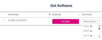

2024-02-04 2:01 PM - edited 2024-02-04 2:06 PM
I can't find it. You know where can I download it from?? and once I got the file, where do I put it??
2024-02-04 2:39 PM
Here: https://www.st.com/en/embedded-software/x-cube-touchgfx.html
Click on "Get software". On this page click on Select version and select 4.23.1.

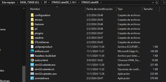

2024-02-04 3:13 PM
Ok and what file should I put the .zip in? Cause I tried in the repository but the IDE gave me an error.
I got another ST folder on another disk but I don't know.

2024-02-05 6:57 AM
Right but I don't know how to install the extension to STM32CUBEIDE "en.X-CUBE-TOUCHGFX.4.23.1.zip".
I know I have to select Help / Manage Embedded Software Packages and then press "From Local" and search this file, but I dont know what folder this file should be in. I already have installed the TouchGFX Designer
2024-02-05 8:54 AM
Hello
By default, downloaded files are placed in the download- folder (windows: C:\users\your name\downloads). On the othr hand, there is not any specific location where file must be.
Br JTP
