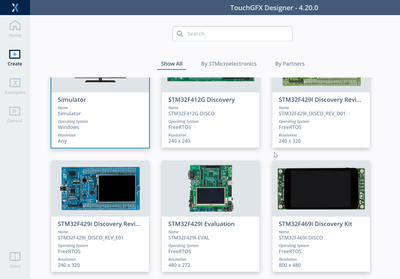

One option is to install TouchGfx Designer and look at the supported boards, then you can develop what you need on these and continue with your own design. There is a series of STM32 Discovery boards supported. For example the STM32F429I has 240 x 320. There are also references on the internet how to port TouchGfx to ILI9341 based boards typically supporting 240 x 320. If I was you and wanted to go the GFX path, I would first invest in a SM32F429I, make this work and then continue. The code generated by TouchGfx can be compiled with STM32Cube IDE and then downloaded to these boards without much problems.
