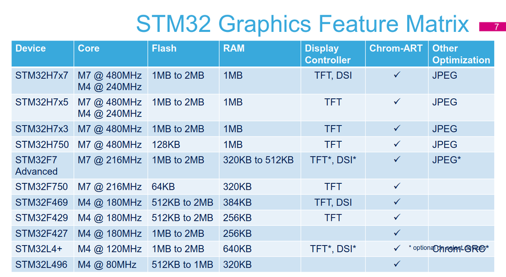

As far as I know there are specific models for using graphics, F4x9 etc. I use an STM32F407 with SPI display but in very simplified mode, low performance.

I haven't used touch GFX in a while, and likely things have changed.
However, TouchGFX and similar programs rely on being able to write data to a specific pixel. If it's not a supported ST board, you're in the soup for making it so.
Now this does not mean that I understand the specific drivers in TouchGFX, but in general you need:
Different graphics programs may need more or less, but that is the minimum you need.
Generally, you need to provide a method for doing the above, which can involve having access to low level SPI drivers (HAL will work, but you may need one chip on one interface). These low level drivers depend on how your chip interfaces, how much graphics memory it has, how to access the registers on the control chip, and so on.
Many other programs (emWin, STemWin, uGFX, and so on, including what I have written) effectively do the same. There are more methods of writing to a display, but what I've mentioned are the simplest. Again, what kind of display, what kind of interface, and the display chip, all play a part.

2023-08-27 7:16 AM
For 320 * 240, you need about 300K worth of pixels, which if you maintain full 32 bit color (ARGB) is about 300K of 32 bit memory. While the processor does not have it, you have external memory that does. The parallel method of connecting the board to the display is what's on the board, so you'd be using a memory mapped LTDC configuration.
There's no demo for STemWin for that specific board, but you might want to look to see if one of the available demos might run.
For TouchGFX, there may be a demo, but I don't know.
Bear in mind that all of the demos generally use BSP drivers.
I'm not going to be an expert on TouchGFX, and I'm awaiting a response from ST on how to get STemWin up and running (I have some very particular questions).
Of the two, TouchGFX is more the current product and is likely better supported. STemWin has perhaps more of a cross platform capability.
