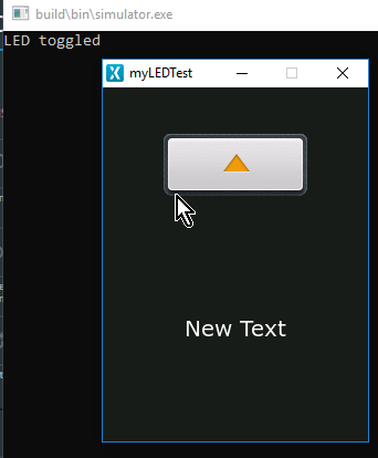

By moving the hardware specific code from your Screen1View to the model, guarding it with #ifndef SIMULATOR and instead just printing something if the button is pressed in the simulator, i can achieve the following in the simulator, whereas in my EWARM project the SIMULATOR flag would not be set and i would instead call the code you had originally in the led() function:
