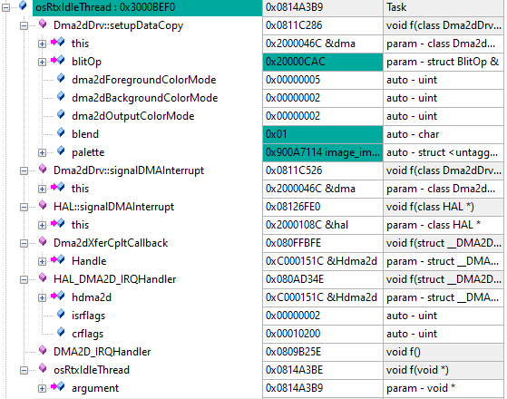

You added the function OSWrappers::taskYield() when using L8 images.
TaskYield() is called in the function setupDataCopy.
The problem: setupDataCopy is also called from ISR as you know, TaskYield() is not allowed to be called from ISR and you get Thread-Errors.
I think this should be fixed in the next release...

unfortunately I cannot share our project. I'm working on a custorm HW.
I attached the stack trace. Maybe it helps.
Please let me know if you need any more information.

Hi again,
I've been told 2 fixes you could try:
1) In OSWrappers.cpp change taskYield to only call osThreadYield if not in interrupt context, using this function:
portFORCE_INLINE static BaseType_t xPortIsInsideInterrupt( void )
2) Change setupDataCopy to not call yield if in interrupt context, or never call yield.
/Romain
