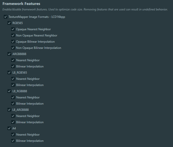

2021-03-14 6:44 PM
Hello @Community member ,
Analog Clock utilizes texture mappers for the hands.
But the G0 Application template disables the texture mapper by default for several reasons :
You can try re-enabling the texture mapper feature by opening your project in the Designer go to Config -> Framework Features
When enabled, you should see the following :
/Alexandre
2021-03-15 12:33 AM
Hello @Alexandre RENOUX,
I have enabled the texture mapper. Flash occupancy increased by 50% (from 64k to around 96K) !!
However, the hands are not displayed.
I'm definitely not going to use widgets that require texture mapper on this hardware, but I wanted to point this out.

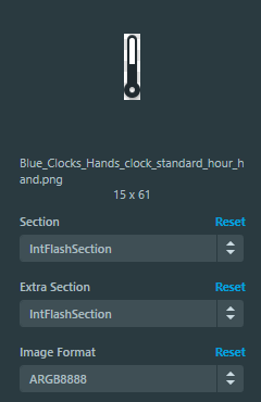

2021-03-15 2:51 AM
Hello @Alexandre RENOUX ,
putting the hands images into internal Flash and force them to be ARGB8888 solve the problem.
I only tried with the second hand (not much free space in the internal flash).
I can not choose "Select as Best", because I believe I did not open this ticket, but @SimonF .
He could do it.
Thank you
/Antonello
