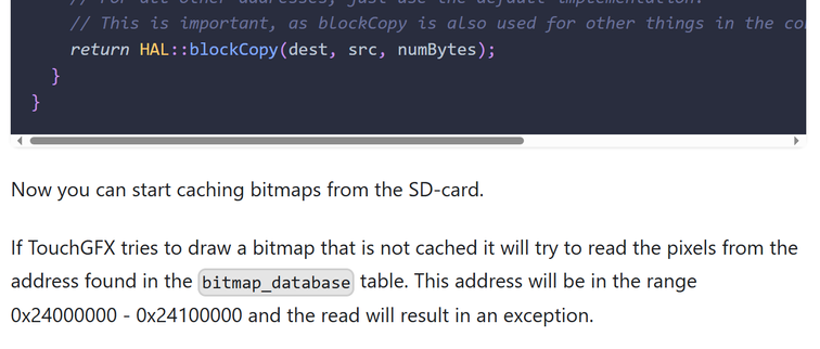

2024-05-28 7:55 AM
Part of docu
as i write now unsupported.
2024-05-28 8:12 AM
2024-05-28 8:17 AM - edited 2024-05-28 8:35 AM
OK and i and docu say you cant. Because all lib code is optimized to load images from addressable memory.
Nothink more. Then for non mapped is required precache image to addressable arrea.
Maybe you can create special widget external image and draw your way...
Actual latest version support only this LCD16bppSerialFlash | TouchGFX Documentation
