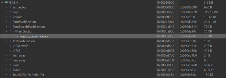

after compilation this my external memory:

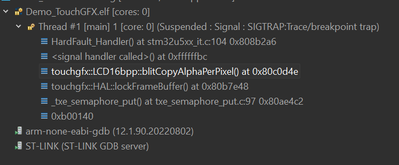

This is the Trace:

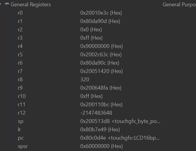

And these are the registers:

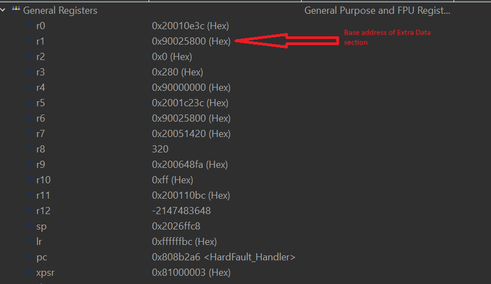

I came across this post and suspected it might be related to a known TouchGFX bug. I decided to move only the extra data to the IntFlashSection, which initially resolved the issue. However, when I tried changing the background image from bg_1.png to bg_2.png, a hard fault occurred again....here there are trace and registers
This time r1 is contains the base address for Extra Section of bg_2 in internal flash. So memory access should be ok....

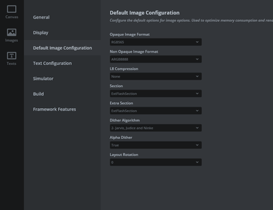

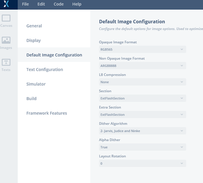

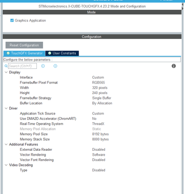

- linker script
- clockCopy function
- screenshot of your parameters in Designer :
- screenshot of you x-cube-touchgfx configuration in STM32CubeMX :

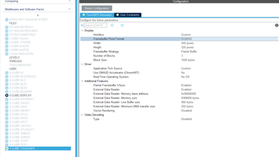

Hi Gaetan, I've done even more tests to answer you, so now consider this situation:
1) Full black background (RGB565): no problems, it works both using internal memory or external flash throught my BlockCopy function.
2) Black background with tranparency (any) (ARGB8888), as you mentioned:
This is my block copy function:
bool TouchGFXHAL::blockCopy(void* RESTRICT dest, const void* RESTRICT src, uint32_t numBytes)
if ((uint32_t)src >= 0x90000000 && (uint32_t)src < 0x94000000)
uint32_t dataOffset = (uint32_t)src - 0x90000000;
char file_name[] = "media";
uint32_t ret = fs_read_file(file_name, dataOffset, numBytes, ((uint8_t*)dest));
if(ret == numBytes)
return true;
else{
memset((uint8_t*)dest, 0, numBytes);
return false;
else
return TouchGFXGeneratedHAL::blockCopy(dest, src, numBytes);
}This is my Designer configuration:
This is x-cube-touchgfx configuration in STM32CubeMX :
This is the image section:
The memory details:
The HardFault error:
