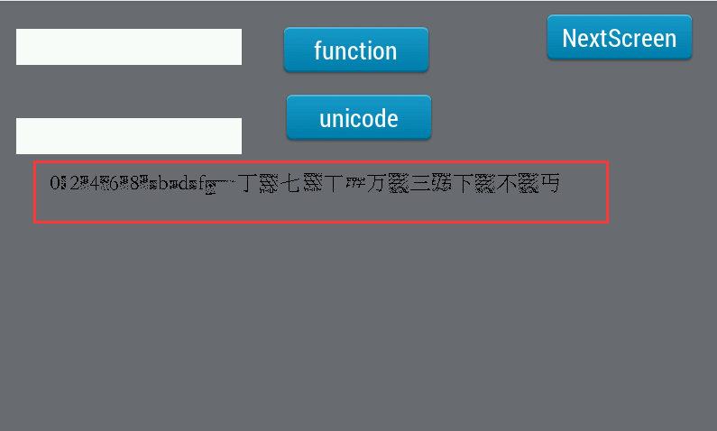

I have patched binary font to the system. However, the binary font look incorrect as following picture:
void screenMainView::testClick()
Unicode::fromUTF8((const uint8_t*)"0123456789abcdefg一�?丂七丄丅丆万丈三上下丌�?与�?",
this->textAreaTestBuffer, TEXTAREATEST_SIZE);
this->textAreaTest.invalidate();
It looks like the odd unicode can not get correct font data. or the data in font bin file is not correct.
I use designer 4.13, hope someone can help me.
thanks.
2020-02-11 2:23 AM
After debug for some time, I found It is fault of my hardware board configuration. The font table access is not 4 byte aligned. It's ok after I enabled sdram's cache function.
