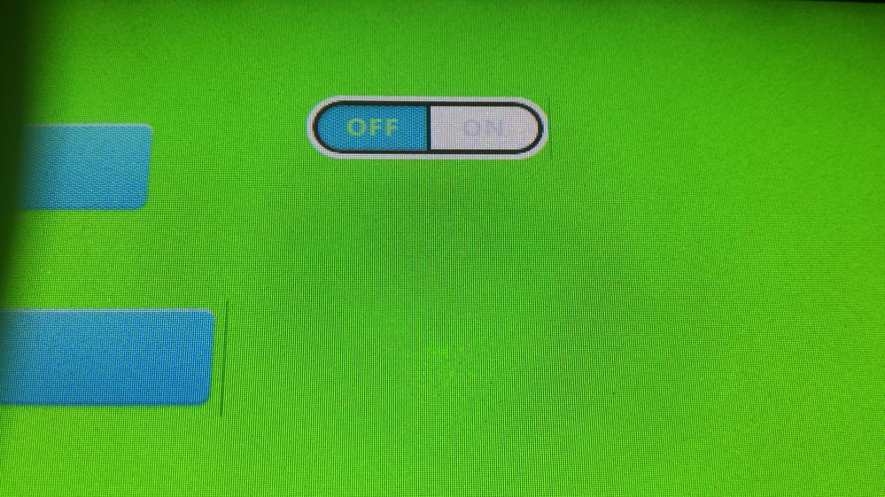

Hello! Look at the picture.
Artifacts - is lines at right side of widget
Can you say me possible course oth this artifacts?
I llok at memory window in KEIL - artifacts are in memory, is not LTDC artifacts

If I try to draw graphics without DMA - no artifacts. If I draw to SRAM - no artifacts
If I draw to SDRAM by DMA2D - I have artifacts.

I almost find..... If I delete nbl0,nbl1,nbl2,nbl3 from initialization - such artefacts appears on each widget and on both sides. I think, that problem is in these lines... but how to solve it....

Yes, these artifacts apperas only with DMA2D.
Look - I disabled TouchGFX, I disabled LTDC initialisation, I made Init of system, sdram init and dma2d init.
I try to write to sdram some data with dma2d, like I draw filled rectangle. And I look to sdram memory by Keil debugger. I, see that first abd sometimes last bytes of each line is broken.
